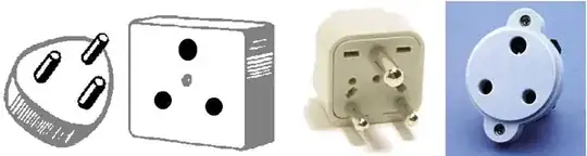

By the looks of it, the adapter will work as long as you have the "adapter"!
India
230 V
50 Hz
Type D Socket and Plug
Australia
230 V
50 Hz
Type I Socket and Plug
source
JoshP
  • 2,272
  • 28
According to this chart, both of those countries use 220-240 Volts at 50 Hz. Your adapter says that it does support those voltages and cycles.
However, you will need adapters for the shape of the plug so that your plug will fit in the socket. Most electronics stores carry these fairly cheaply.
