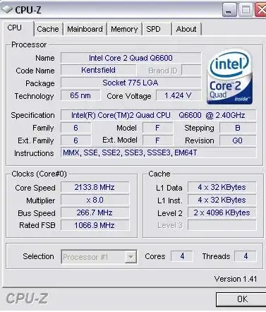

The motherboard will make both RAM modules runs in the lower speed (unless you choose manual instead of auto RAM setting in BIOS), in this case 533MHz.
You system should be fine and you can use CPU-Z to check out the ram speed.
