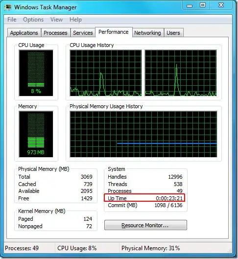

The main difference between Windows 7 and Windows XP that in Windows 7 Microsoft can show only last boot up time.
Also in Task Manager:

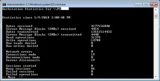

Another way to do this is to use the following command which I tested successfully on Windows XP, Windows 7 and Windows 10:
net statistics workstation
It is faster than systeminfo while formatting the date (which wmic does not). You can find more informations on the net statistics command here: http://technet.microsoft.com/en-us/library/bb490714.aspx
Here is an example of the result:
example
More details on http://en.wikipedia.org/wiki/Uptime about the accuracy when determining system uptime.
Additional notes from the comments: this method determines when the workstation service was last started, not the computer uptime. While this should in general be the same, the 2 numbers might be different if you use sleep/hibernate.
dan
  • 484
    any idea why this doesn't read the same as using systeminfo or wmic... it's probably negligible, but it differs on my system by over 2 minutes – Anthony Shaw Dec 11 '14 at 20:31
  • It does differ for aobut 40 seconds on my computer too. I don't have any idea why it's not exactly the same, I guess the service just boots a little bit latter. Some interesting info on http://en.wikipedia.org/wiki/Uptime – dan Dec 11 '14 at 21:33
    It differs by over nine months on mine :-) This is the only correct answer. It gives the actual datestamp of the last boot (or when whatever associated service started after bootup, so very close to it), whereas `wmic`, Task Manager, and `systeminfo` all seem to count backwards from the current time by the number of ticks the PC has been running. But if you put your computer to sleep (or hibernate) a lot, like I do, the actual total *running* time is much less than the time since the last boot (only thirty days in my case over the last several months), throwing off that calculation completely. – Cameron Feb 12 '16 at 06:05
  • Thank you @cameron, I added a note at the end of my answer. The original question was really about when the computer started and not its uptime, so that's an important detail. Wikipedia does somewhat mention the difference in the uptime article I linked. – dan Mar 10 '16 at 15:08
    That isn't really the last "boot" time - it's the time that the Server or Workstation service started, depending which one you query stats for. Since these don't ever stop during a regular Windows session, it's a convenient approximation of last boot time. – oldmud0 Jun 07 '17 at 15:50

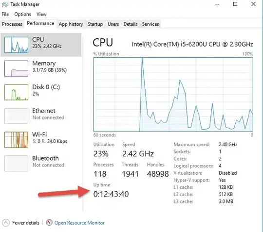

For Windows 10 users out there....
System Properties Windows 10 - Performance Up time
user
  • 29,449
  • 99
  • 144
Jonathan Tepper
  • 121
    This shows you the *uptime* (i.e. how long the system is running) not the time when the system has been started as OP asked. – David Ferenczy Rogožan May 03 '18 at 20:25
    True, but this is still useful. – tbc0 Jul 13 '18 at 17:29
    Today my Windows 10 notebook is showing a bogus uptime. I shut it down last night, powered it on less than an hour ago, and Task Manager says it's been up for 5:19:40:10. – tbc0 Oct 25 '18 at 14:15
    Windows 10 does not actually shut down when shut down, I forget why exactly. However, if you want the uptime timer to reset you must restart. – Daniel Hayes Nov 01 '18 at 18:16
  • @DawidFerenczyRogožan Current time - Uptime = The time OP asks for, right? – klutt Dec 04 '19 at 15:48

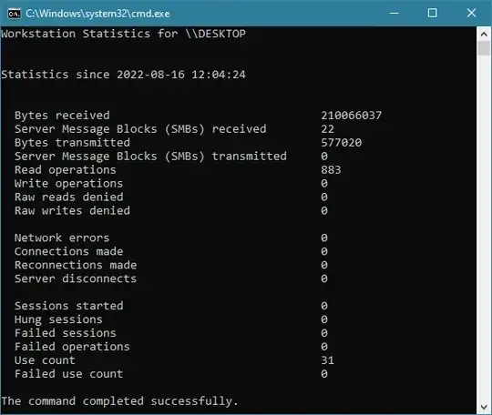

A couple of answers mentions net statistics workstation and I've noted that both :
net statistics server
and
should provide data regarding last boot on the Statistics since ... line.
However, some OS versions (like Svr2008/6.0) will return 1/1/1980 12:00 for the date when using server. So I'll default to workstation.
Also you can abbreviate some of the command like net stats workstation and get the same results. Finally, if you jump around from system to system, the default CMD box isn't large enough to show all results from the command. So I'll pipe the output to more to avoid scrolling up to see the boot time. Therefore, my default command is:
net stats workstation | more
command
C0deDaedalus
  • 2,500
