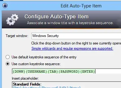

I use the KeePass AutoType feature to log in to various RDP sessions in the network.
On the Auto-Type tab I add a custom sequence for a specific window.
KeePass Auto-Type custom sequence

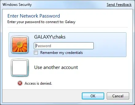

To add the entry I use the default sequence but add {DOWN} to the beginning of it. This means that it doesn't matter what username is currently displayed in the security details as the {DOWN} sequence forces it to use the "Use another account" option.
To set up the custom entry you need to have the Windows security dialog open and waiting for input then go into the KeePass Auto-Type tab and press Add then fill in the box as shown:
Works for me!

    I use KeePass to log into the hundreds of Windows servers that we maintain. It should be noted that KeePass cannot log into Windows XP/Server 2003 machines. – Jerry Sweeton Jan 04 '13 at 14:50
  • So it can't. Hadn't noticed that. – shunty Jan 04 '13 at 15:21
  • Is that a version of keepass that isn't free? my keypass autotypes(in general anyway) though doesn't have those tabs. I haven't tested it on the credentials though I guess if I did it wouldn't work and would have the same issue as the op. Are you using Classic edition or Professional edition, and if the latter, then is it still free? – barlop Jan 05 '13 at 07:18
  • It's v2.20.1 the latest "professional" version - and yes, it is most definitely free. – shunty Jan 07 '13 at 09:01
