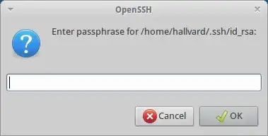

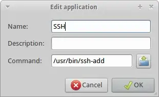

I think this is what you're looking for:
Setup of SSH agent in Xubuntu 11.10 to get password-less authentication with use of public key | Hnygard.no
If you have not already done so, set up your private and public key (See Githubs description about SSH key half way through Set Up Git). It is important that you add a passphrase to your private key.
Install the package ssh-askpass:
sudo apt-get install ssh-askpass
Add «/usr/bin/ssh-add» to your start up. Go to Settings – Settings manager – Session and startup. Go to Application Autostart and add an item that runs the command «/usr/bin/ssh-add«:
On next login you’ll get the following dialog asking for your passphrase. After entering it, you can open a terminal or use sftp in the file manager without typing a password.

  • thx, this works for me! – Produnis Apr 05 '14 at 20:44
  • No luck for me. Do you understand how `ssh-add` invokes `ssh-askpass`? That's not clear to me. – Air May 24 '14 at 15:14
  • This is by far the best method I've found for working with ssh keys on XFCE. Easier than using the terminal and a lot less bloated than installing the entire gnome keyring system. Thanks! – Marlies Jul 15 '14 at 10:01

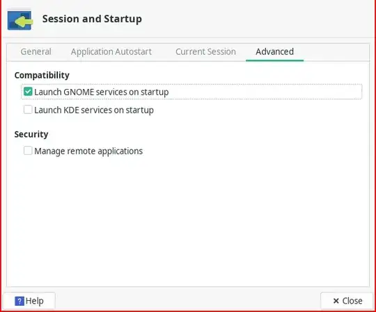

I've also recently switched to xfce (i3 standalone to xfce+i3) and had the same issue.
In i3 I started /usr/lib/polkit-gnome/polkit-gnome-authentication-agent-1 and put export $(gnome-keyring-daemon -s) into .bashrc, but in xfce that only worked for bash terminals, not for other applications like virt-manager.
But it turns out there is a simple gui setting for that:
In "Session and Startup":
  1. in the tab "Application Autostart" enable "SSH Key Agent (GNOME Keyring: SSH Agent)" (And if you want the other 2 gnome keyring entries)
  2. in the tab "Advanced" under Compatibility enable "Launch GNOME services on startup"
xfce -> Session and Startup -> Application Autostart
xfce -> Session and Startup -> Advanced

Just enable Gnome Services in the "Session and Startup" configuration.
Settings->Session and Startup->Advanced->Launch GNOME services on startup
