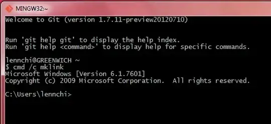

  • If I do cmd /c mklink the mklink command is not executed and the CMD shell is not exited.
Before pressing Enter:
After:

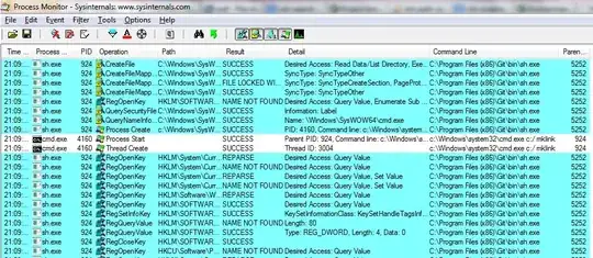

Process Monitor screenshot:

  • @NicoleHamilton, screenshots added. For `mklink` to work, the shell does indeed need to be run as administrator; but my problem is that I can't run any of the internal commands without the `cmd` shell either taking over or running in the background. This issue is also present for simpler commands which do not require admin, such as `dir`. – Mihai Rotaru Jan 01 '13 at 19:53
  • Do you have an alias, procedure definition or script that may be intercepting `cmd`? – Nicole Hamilton Jan 01 '13 at 20:04
    @NicoleHamilton, nope; I took @Maxiums' advice and ran Process Monitor, and as can be seen in the screenshot I attached, the issue is that `msys` converts `/c` to `c:\ `. The answer is to escape it, and run the command as `cmd //c mklink`. – Mihai Rotaru Jan 01 '13 at 21:29
16
  1. Search your %PATH% for cmd.cmd or cmd.bat. They may interfere with your cmd
  2. Run Process Monitor and run your cmd /c mklink. Examine ProcMon log for really executed commands.

    Process Monitor helped track down the issue. It is that `msys` will convert `/c` to `c:\ `; it needs to be escaped: `cmd //c mklink`. The way these conversions are done is explained [here](http://www.mingw.org/wiki/Posix_path_conversion). – Mihai Rotaru Jan 01 '13 at 21:32
