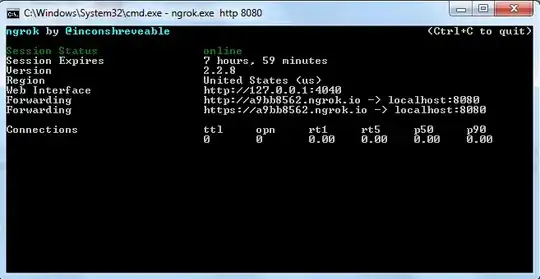

  1. Download ngrok.
  2. Run your service.
  3. Assuming your tomcat server listen on port 8080, run ngrok in command line with this command:
ngrok.exe http 8080
ngrok starts port forwarding and it looks like this:
Now, the client can run request with the url http://a9bb8562.ngrok.io/myapp.
