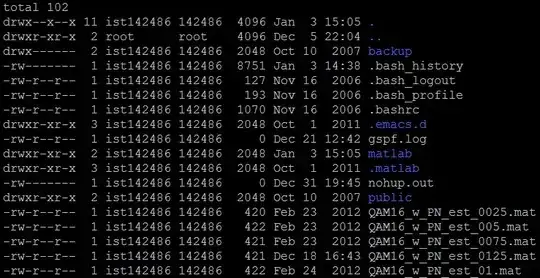

This error message pops up also while using GNU-screen. If I run ls -al $HOME inside my GNU-screen session before log out I'll have
command before log out

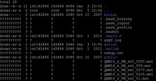

I detach form the GNU-screen session, log out, log in, and reattach to the screen session just to find that I lost access to files which I used to have access to inside screen. The output of ls -al $HOME is now
command after log out
