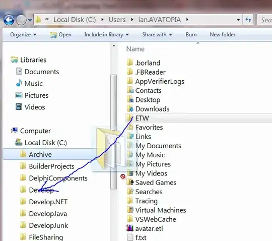

Edit: Another thing you should consider is that you dropped the photos folder inside one of the other ones, maybe the videos folder.
to check, pull up cmd switch to the thumb drive e: (or whatever) and run dir /S /A /p -- this way you can scroll through all of the legitimate files on the disk. You can also compare the size of the video folder to the 15.7 GB you mentioned above. Keep in mind that dir's output is in bytes, and 15.7 GB is something like 16,857,700,000 Bytes.
