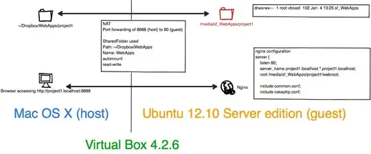

My setup
I want to setup a Ubuntu VM to act as a web server for development.
Reason
I want to have a development environment as close to the actual production environment as possible.
Problem
The above setup failed. I keep getting a File Not Found when I navigate to http://project1.localhost:8888
What I tried
I did add www-data to the group vboxsf using
sudo adduser www-data vboxsf
before trying any of the below.
  1. As mentioned, I tried the above setup. File not found error on webpage.
  2. I tried the above setup but symlink from /var/virtual/project1 to /media/sf_WebApps/project1. File not found error on webpage.
  3. I tried to chown the /media/sf_WebApps from root:vboxsf to www-data:vboxsf. Not possible.
  4. I tried to chmod the /media/sf_WebApps to 755. Not possible.
  5. I made a copy of /media/sf_WebApps/project1 and place the copy inside /var/virtual. This works, but this is not what I want. Why not? Because I want to easily use my host programs like github mac app and sublime text editor to make changes to the code base and see it reflected when I visit on browser.
