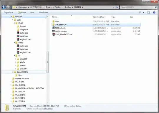

I am having this EXACT same issue. You execute the .exe (in my case in the USA folder) and the installer launches, then crashes.
To explain more technically, see the image below. The 8860inst.exe extracts and creates the directories DATA and Setup8860DN. At the end of the extraction, you are asked if you would like to launch the Setup.exe in Setup8860DN\USA\Setup.exe. At this point the install shield wizard loads, finishes, then launches the install shield wizard. Setup Folder Structure
Then you see this screen for a couple seconds: Install Wizard
Then it disappears. No Windows application error, nothing in the installer log. Interestingly enough, we have another machine, exact same make and model, same Windows XP and service pack, and it installs with no problem. Very, VERY frustrating.
