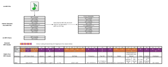

For the record, that's not the best way to merge MP3s.
It works, but it leaves superfluous information (the ID3 tags) from the subsequent files in the final file. Copy, when used that way, is just a concatenate - the extra header information is still in there.
The structure of an MP3 file can give you an idea:
(Click to zoom)
Tom Ritter
  • 1,126
    This is very interesting, but it doesn't answer the question. It might be more relevant here: http://superuser.com/questions/202809/join-multiple-mp3-files-lossless – Nathan Fellman Nov 10 '13 at 08:16
  • If the tags are a concern, you can remove all tags first, but then you'll have to add them back in afterwards. – Mr Lister Mar 18 '14 at 09:34
  • Nice, but the question was not about merge, but about split. – Shai Alon Apr 02 '18 at 09:25
