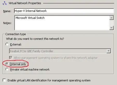

I would recommend against using a wireless connection with Hyper-V, as it can cause no end of issues when trying to connect to networks.
You could try changing your Hyper-V network to an Internal network:
This appears as a new virtual network adapter in your host:

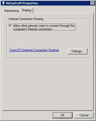

Then depending on your needs, either enable Internet Connection Sharing on your wireless adapter:
