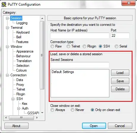

  2. Set up Putty (saves you time later)
    Enter the IP and Port (As you have been doing)
    On the left, navigate to Connection > SSH > Auth, find your private key file in the "browse" dialog.
    Navigate back to Connection > Data, specify your Auto-login username
    Finally, go back to Session, and you can specify a name to save the session under.
After all that, you should be able to login. That is, assuming the IP is correct. To avoid confusion, I personally would use the actual IP of the machine. But if the LO works through the other port, that is fine to use.
