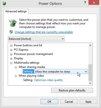

It is an issue with HOMEGROUP in Win8.1 Pro. Mind you, the HOMEGROUP computers that are preventing sleep don't even have to be turned on! Basically, I had to take the three computers in the house and have them leave the old HOMEGROUP. I then created a new HOMEGROUP with a new password and made sure that I could share files and folders back and forth. One computer was a bear and I had to stop sharing entire folders and files (shift-left click to select all files and folders, right click-sharing-stop sharing) and then share the one folder that I wanted to.
To verify that this is your problem, just disable the network adapter and set the sleep to one minute. Wait 5 minutes and see if it sleeps.
Now the two Win8.1 Pro computers sleep! (takes a couple of minutes to fall asleep so some patience is needed).

In my particular case, leaving the homegroup immediately fixed this problem. Note that setting 'When sharing media -> Allow the computer to sleep' didn't fix it at all.
My powercfg /requests was identical to the one shown in the original question.
