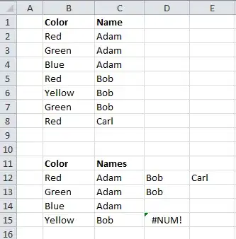

Assuming you want a formula approach as stated (not using VLOOKUP, but still a formula), here is how I laid out the data:
Data Layout
I then used the following formula in cell C12:
=INDEX($C$2:$C$8, SMALL(IF($B12=$B$2:$B$8, ROW($B$2:$B$8)-MIN(ROW($B$2:$B$8))+1, ""), 1))
This is an array formula so after you copy and paste it into the cell you have to hit Ctrl+Shift+Enter. I then just dragged it to the right and to the bottom.
If there is no value(s) remaining it gives the #NUM! error, I gave an example for yellow in the uploaded image example.
