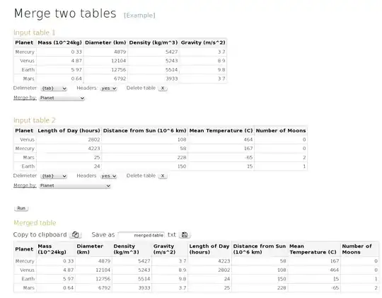

If you just want a result on a one-time basis, there is a web site that will merge two tables for you: https://office-tools.online/table/merge/
You paste the tables into the web page and select the relevant parameters. Here's a screenshot of the built-in example that indicates how to use it:
