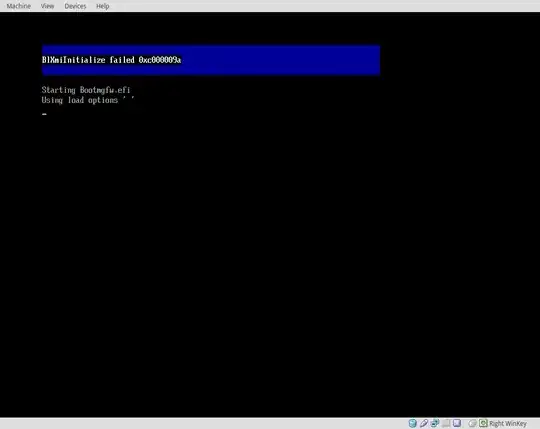

The next hitch is EFI. I enabled EFI booting in VirtualBox, but whenever I boot the EFI/Microsoft/Boot/bootmgfw.efi image, I see the following code:
BlXmiInitialize failed 0xc000009a
boot error
and it doesn't boot. Plus, having to use the actual UEFI shell to get things booting is at best a hassle.

I still can't get past the boot error, though.
I figured it might be because of other problems, so I tried using my Windows 7 installation disk for startup repair, but it doesn't seem to even see the Windows installation, as the disk prompts me to simply install Windows.

  • What do you mean? This is a VMDK image which is pointing to my real Windows 7 installation on disk. I can boot into Windows 7 just fine on physical system startup, it's just not working in VirtualBox. I'm beginning to think it's an EFI error. – Naftuli Kay Jan 23 '13 at 20:08
  • Does it give you the same error with the new VMDK setup? – John Siu Jan 23 '13 at 21:35
  • Yes, it does give the same error. – Naftuli Kay Jan 23 '13 at 22:15
    That may very much be bios/efi info different as the 2 efi, vb and mb is reporting very different thing to Bootmgfw.efi. If you have a spare HD, we can test by setting it up as another VMDK, then install Win7 on it with Virtualbox, then bootup the machine with that drive, very likely it will show the same error. – John Siu Jan 23 '13 at 22:26
  • @JohnSiu I think so too. – Shane Hsu Jan 28 '13 at 23:22
According to members of the VirtualBox team and according to the VirtualBox manual:
Note that the VirtualBox EFI support is experimental and will be enhanced as EFI matures and becomes more widespread. While Mac OS X and Linux guests are known to work fine, Windows guests are currently unable to boot with the VirtualBox EFI implementation.
It's pretty lame, but true. Interestingly enough, it'd be arguably more difficult to implement EFI for Mac OSX than for Windows, as basically every modern motherboard has UEFI firmware that "just works™" with Windows, whereas Apple uses their own proprietary EFI implementation designed for their own hardware.
TL;DR: As of the writing of this post, EFI support doesn't really work with Windows in VirtualBox.
