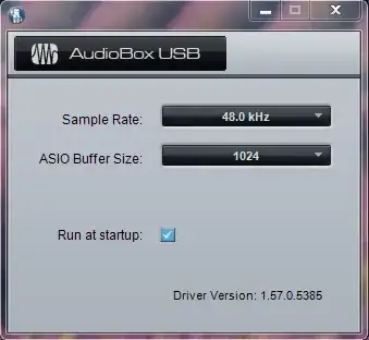

The soundcard's driver software does not provide too much help:
Sound card driver software

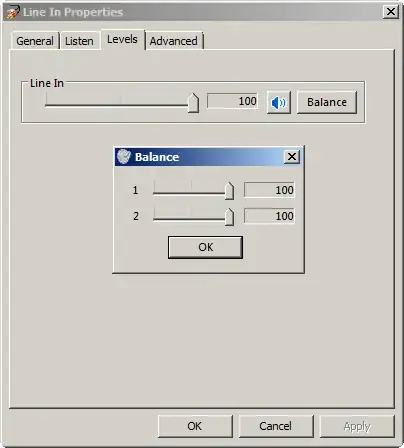

If you can use windows native audio controls you can do the following:
  1. Go to the Control Panel (from the Start Menu or My Computer)
  2. Navigate to Hardware and Sound -> Manage Audio Devices
  3. On the Recording tab, select the recording device you are using and click the Properties button in the lower right hand corner.
  4. In the dialog that pops up, on the Levels tab, there should be a Balance button.
  5. Lower the volume of the right channel to zero.
peanut_butter
  • 1,812
  • But does it copy the left channel to the right? – varesa Jul 04 '13 at 18:05
  • If you are not getting any audio from the right channel, why do you want to merge it? – peanut_butter Jul 04 '13 at 18:20
    Well I want to have either a stereo device with the "left mic channel" on both channels, or a mono device with from the left channel. So for example in skype or other voip programs the others hear my voice through both channels – varesa Jul 04 '13 at 18:37
