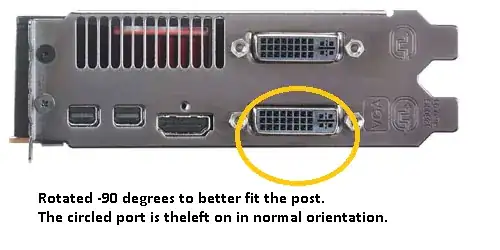

I have an Asus Radeon 6870 with four places to connect a monitor.
I am using three 1920x1080 monitors, connected to the following ports:
   Card                         Monitor
   DVI    -------------------->    DVI
   HDMI   -------------------->    HDMI
Mini DP   ----> Convertor ---->    DVI
This is the convertor I use: Mini DisplayPort to DVI converter
My card detects all three monitors, but when I go to extend the desktop onto the third monitor, this error comes up and I cannot get all three to work at the same time.
"To extend the desktop, a desktop or display must be disabled." with "Continue" and "Cancel" as options.
I tried the left DVI, the HDMI and I have tried both Mini DPs with the adapter.
I have looked at the other thread on this site in order to solve this problem, still no working solution.

  • I added the extra information gained from this last set of forth and back comments to the post. Can you check if I got it right? After you verified it can you delete the remaining comments to keep the post clean? – Hennes Jan 19 '13 at 19:56
  • I think the make is "Powercolour", Just checked inside the case to verify. It does look an awful lot like the asus one! http://img.directcanada.com/images/POWERCOLOR/AX6870_1GBD5-2DH/AX6870_1GBD5-2DH_1.jpg – Dagarian Jan 19 '13 at 20:05
