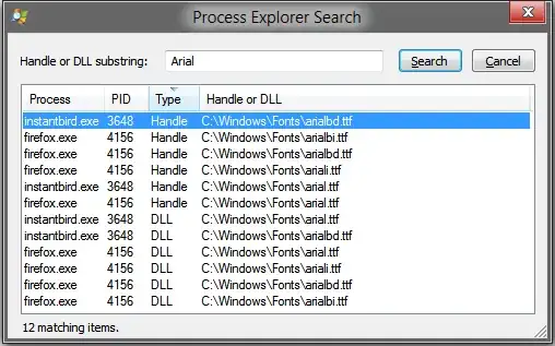

The feature you are looking for in this tool from Microsoft is as simple as it gets, it's CTRL+F which allows you to substring search for Handles or DLL files. If you would rather use your mouse and the menus, you can click on Find ➯ Find Handle or DLL.
Let's suppose that the Arial font files are in use, we can simply search for Arial and get to see that Instantbird and Firefox like to keep that font file in use. Let's suppose I would want to delete that file, I wouldn't be able to do so. Let's put a change to that and get rid of the Arial file. Don't do this at home...
Process Explorer Search
A simple fix would be to just close these two programs, while this works for Instantbird it seems that I can't shut down Firefox because I am writing this answer for you. And I don't want to risk losing my answer because of a cache timeout or a clipboard failure. So, I'm going to close all the Firefox handles to Arial.

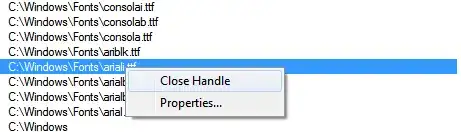

Make sure Process Explorer is started as an administrator, then select File ➯ Show Details for All Processes
I simply select the handle in the search window and Process Explorer will automatically select Firefox and jump to the right entry in its main window. Make sure that you do this on a handle and not on a DLL, it might or might not be that you need to close the program if it were a DLL. It's time to close those handles so that I can remove the Arial font files for no reason; well, I can always restore them from a back-up...
Close handle
So, I simply right click on the relevant entries and click Close Handle.
And now, with a Firefox that has no Arial handles I post my answer; the font is loaded in anyway...
