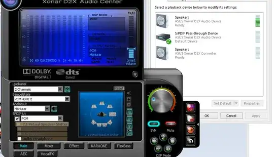

I'm using S/PDIF and I only get sound from the right speaker plus the subwoofer.
I've checked the balance settings:
Adjusting #1 does nothing. Adjusting #2 affects the right speaker.
I've also tried:
  • Switch places for the speakers to make sure that both works
  • Switch the cables
Same thing. Only audio from the right speaker. So I'm quite certain that it's not a speaker problem but how windows sends the audio (or sound card problem).

I've bought a new sound card (Asus Xonar D2X). Almost the same thing. Now I only get sound from the left headphone.

There is a setting that changes the output format of the audio. It is my suspicion that the left channel of your audio is being routed to your subwoofer. Windows may not be autodetecting your speaker configuration properly and might be sending a stereo signal to your speakers incorrectly.
Try right-clicking the sound device and clicking Configure Speakers, instead of double-clicking to get to Properties.
A configuration wizard should appear, starting at the "Speaker Setup" step. It should let you change the output format of the sound. Choose the one corresponding to your setup. For instance, this is what I see when I do it on my laptop:

  • I'm using optical SPDIF. If the cable was broken I would have got no sound. And I can't configure the SPDIF as you showed, that only works for the "speaker" setting – jgauffin Feb 05 '13 at 19:29
  • I just tried this with a regular cable instead. I can change the setting, but it didn't help. – jgauffin Feb 06 '13 at 16:44

I had the same problem (Windows 7 x64) sound on the right speaker only. Here is the solution:
I changed speaker properties from 16 bit-48000 Hz to 24 bit-48000 Hz. SOLVED.

If only one speaker works in Win 8.1:
  • click the little up arrow at the right end of the bottom toolbar of the retro desktop screen with traditional icons (not the new apps screen)
  • click the speaker icon, which opens Realtek HD Audio Manager
  • choose Speakers at top
  • click Speaker Config
  • choose Stereo
  • click blue Auto Test arrow
  • both speakers should now be audible in the test, worked for me.
