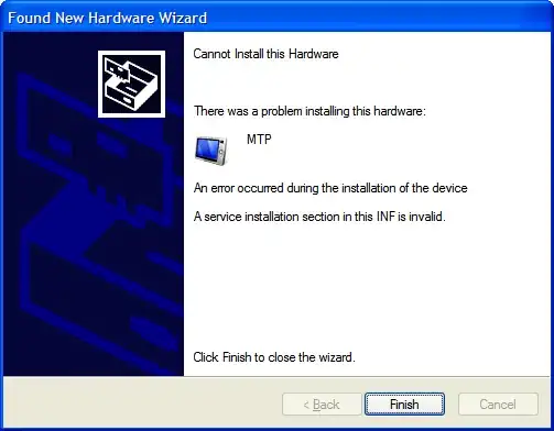

When I connect a Samsung phone to my Windows XP SP3, it gives the error
A service installation section in this inf is invalid
I browsed lot of blogs, every post says to try the Microsoft_User-Mode_Driver_Framework_Install-v1.0-WinXP.exe. But when install this, I get another error
Wudf01000 Setup Error
Access is denied.

Give this a shot:
Open up your c:\Windows\System32\ folder
Is there a file named LogFiles? If so, delete it
Is there a folder called LogFiles? If not, create it
Then try installing Microsoft_User-Mode_Driver_Framework_Install-v1.0-WinXP.exe
Keltari
  • 71,875
  • 179
  • 229
    There is one folder called `Logfiles`, but I could not delete it. The process `inetinfo.exe`(IIS, I think) locks some files of the folder. – Rauf Feb 04 '13 at 15:09
Read this link to enable wudfgroup registry.. and then just update the driver of the MTP from Device manager. It worked for me.
http://support.microsoft.com/kb/873148
