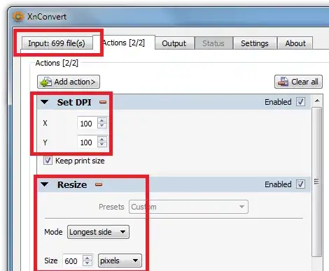

Xnconvert (portable) can process thousands of images
In your case you can try
  • set a lower DPI
  • resize to a lower resolution
  • choose another file format
  • choose another compressing method

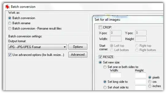

IrfanView would do the job for you. It has a "Batch Conversion/Rename" tool that you can do a lot of things with, including resizing.
From this tutorial on resizing images with IrfanView:
  1. Launch IrfanView and hit the B key. This takes you into batch mode.
  2. Add all files or entire folders to input files
  3. Change the output format and change the quality percentage
  4. use the Advanced option to resize all files
Note that IrfanView is free for non-commercial use only.
