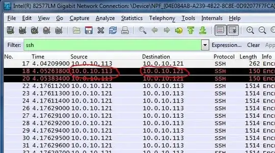

Remote Desktop Connection Established. And as you can see it looks as if it is coming from devilsmilk on duclaw. But according to kgraves-PC it is coming back from Devilsmilk. So what I previously thought was happening actually wasn't. I thought Duclaw was sending the RDP session back to kgraves through a separate path but it turns out it wasn't. I'm not sure if it was working last time and I had a different set up or if I was imagining things. But now that I got it all reconfigured and back up and running after my issue with my ssh servers it is definitely not doing that anymore.
This is wireshark running on kgraves-pc during the RDP session:
So my problem still remains that I want Duclaw to send the RDP session back to Kgraves-pc through a entirely separate reverse tunnel. That is what I need to happen and can't figure out how to do.
Not only do I need duclaw to send it back in a separate tunnel straight to kgraves-pc without going through devilsmilk but I also need to control what Ephemeral port it sends it to. I want it to send it to port :44444 instead of a random ephemeral port. It is using :48809 randomly in the verbose debug ssh print out above.
Hopefully this clears it up, if not...sorry for confusing you even more.

    Is Duclaw<-->Kgraves-PC traffic heavy or light? If it is light, it can be random broadcast or ssh keep-alive or something. – John Siu Jan 30 '13 at 13:22
    To do what you are asking, the only method I can think of is to write a custom rdp proxy and run on both kgraves-pc and duclaw. – John Siu Jan 30 '13 at 13:24
  • Now I am by far no genius when it comes to this. But evidently according to my Trainer (Who is a genius). By the nature of the RFC for 127.0.0.1 (Localhost) the TCP three-way handshake never leaves layer 4 of the OSI model and it has some sort of "features" built into it that preclude the syn syn-ack ack requirement when connecting to 127.0.0.1. Therefore TCP doesn't quite follow the same rules when connected to localhost. He said if you could write a "wireshark" type program to sniff at layer 4 and watch the connection establish you would see what he's talking about. – Kentgrav Jan 30 '13 at 13:28
  • The traffic is heavy. I even tested it. The traffic completely stops almost if there is no interaction with the Remote Desktop Connection window. As soon as I move my mouse around or start interacting with the Remote Desktop the SSH traffic from Duclaw picks up heavy again. – Kentgrav Jan 30 '13 at 13:29
  • He said there is a "virus" that I can use to do this, my job is to find out exactly which virus can do this re-direct for me and try to obtain it. His method of teaching is really "obscur" if you can't already tell. He gives me a task and answers almost zero questions and expects me to be self efficient. Whether I figure this out or not I really appreciate your effort in assisting me John Siu. – Kentgrav Jan 30 '13 at 13:31
    O, I misunderstand your previous comment again. For both Duclaw and Kgraves-PC, the RDP traffic is to and from localhost(127.0.0.1), that is how tunneling work. So heavy traffic is correct. Your tunneling setup works, just the packet flow is not what you wanted. (1) You want rdp packet from Kgraves-Pc to duclaw go through tunnel, this is working. (2) You want rdp packet from dclaw to kgraves-pc go outside the tunnel, that is not working. The packet is using the tunnel. That is why you see traffic. – John Siu Jan 30 '13 at 13:39
    I believe the virus your instructor talk about has the capability to do packet routing, the same idea of a custom rdp proxy, in a sneakier way. – John Siu Jan 30 '13 at 13:43
    'BUT On Kgraves-PC I had SSH traffic coming straight from Duclaw at 10.0.10.130.' I will have to go trace through your tunnel setup again on paper, I think that is because the way your tunnel is setup. – John Siu Jan 30 '13 at 13:48
  • Exactly. They are both talking to `localhost` so I have `localhost` on `duclaw` forwarding traffic it receives on RDP port `1337` to `kgraves-pc`. Or at least I think this is what is happening, but to be honest I'm just confused at this point. I need to take a step back and look at this more and figure out what it is that I am missing or what I need to do before I start looking into any virus or proxy. I feel like the `ssh -R 3333:DEVILSMILK:6666 kgraves@kgraves-PC` command isn't right. I feel like this is redundant becuase `kgraves-pc` is already forwarding `3333` to `devilksmilk` `6666`. – Kentgrav Jan 30 '13 at 13:53
  • First things first. As you can see from my other Question you commented on. In order to test any of this I have to get it set up again. But for some reason I can't SSH into Devilsmilk...which is another mystery in itself. I'm all screwed up. lol – Kentgrav Jan 30 '13 at 13:57
    It is not redundant, but it is not being used. – John Siu Jan 30 '13 at 13:57
  • lol, i will look at that too. Got to go out now. – John Siu Jan 30 '13 at 13:59
  • Please use [chat] for extended discussion. – slhck Jan 30 '13 at 14:13
  • Added further information to my question with verbose ssh print out. – Kentgrav Jan 30 '13 at 22:02
  • I know why `Duclaw<-->Kgraves-PC` has heavy ssh traffic. But this is getting too long here. Create a new question and I will answer there. – John Siu Jan 31 '13 at 02:11
