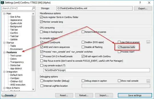

There is "Suppress bells" option.
ConEmu: Suppress bells

    As of Feb 2017, there DOES now seem to be an option in ConEmu settings to "Suppress bells". But for me, it has no effect on the Windows 'Critical Stop' noises I'm hearing all the time (not in tab-complete, but, say, when backspacing on an empty line in WSL Bash) – Jonathan Hartley Feb 16 '17 at 03:08

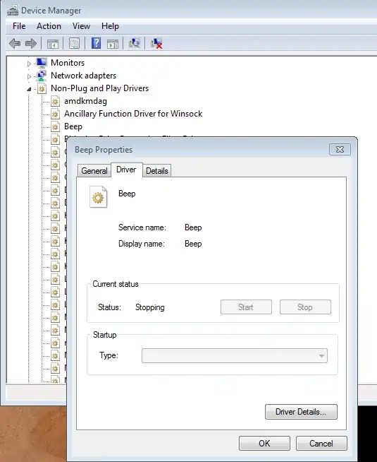

This is not a ConEmu specific solution, but you can disable the Windows system bell if you don't mind never being bothered by this at all. As one of the answers there suggests, you can find "Beep" under "Non-Plug and Play Drivers" in the Device Manager and disable it on the Driver tab under "Startup" (Note: you will need to "Show hidden devices" under the "View" menu to be able to see the "Non-Plug and Play Drivers" section).
device manager screenshot
