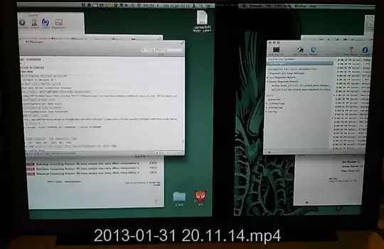

However, as of two days ago, the problem has become substantially more severe. The computer was working fine, when all of a suddent the screen when completely blue. I had to force restart the computer. Since then, the screen has gone awry (see photos below) on numerous occassions - each time necessitating a hard reset.
Two images:
You can see here that the problem isn't restricted to the "blue screen" outcome. In one of the images, there is a severe amount of horizontal distrotion (especially in the menubar); in the other, the screen became split (the left side of the screen is on the right and vice versa!).
I installed gfxCardStatus, and have discovered that the computer runs fine using the integrated card, but as soon as I switch to the discrete card - the screen breaks in some fashion (typically vertical lines, alternating blue and green).

  • I think I would try a full OS reinstall (or just installing a separate partition and testing it) to make sure it isn't software before going as far as to replace the logic board. But if it's hardware, that's the only thing I can think of, as the GPU isn't removeable. – Marcus Chan Feb 04 '13 at 08:51
  • I've been having exactly this issue these days. I even upgraded from Lion to Mountain Lion. I'll have to wait some time before I can do a full reinstall, so I can test that scenario right now. I hope someone know some way to work around this, or if replacing the logic board is the only way. – Wilerson Feb 08 '13 at 01:57
  • Yeah, I want to try booting off of an external hard drive and runnning gfxCardStatus and see what happens, but I'm pretty sure I will run into the same problem. If I do, I have gathered that the only fix is to replace the logic board - which is not going to be cheap! – Twitch_City Feb 08 '13 at 12:35
  • Apple's Repair Extension Program for these machines has ended together with the year 2016. Four options remain: baking the logic board, replacing the GPU alone, sourcing a used logic board – or disabling the dGPU via software like so: https://apple.stackexchange.com/a/295805/251859 – LаngLаngС Oct 08 '17 at 13:17
My early 2011 MacBook Pro just started having the exact same issue. I encounter the same graphics artifacts you do. I can tell you what does not work:
  1. Snow Leopard
  2. Lion
  3. Mountain Lion
  4. Different Memory
  5. Different Hard Drives
  6. Different Power Adaptors
  7. NVRAM Reset
  8. SMC Reset
The only thing I have found to keep the system stable is using gfxCardStatus to force the Intel GPU to remain active. The issue with this is sometimes the system will end up crashing before gfxCardStatus loads. I would love to find a permanent solution which did not involve replacing the system board, but I have pretty much lost hope at this point.
