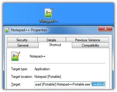

I tested some options from the Notepad++ wiki, and this one worked for me while others didn't.
I know you already mentioned -multiInst. But maybe you are doing something wrong? I just added a detailed description:
  1. Create a new shortcut to your notepad++.exe
  2. Go to Properties of the shortcut (right-click on it)
  3. Append -multiInst to the target line. It should look like this Enter image description here
    Notepad++ v6.2.3.

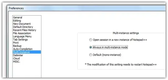

Since Notepad++ v6.4.3 a new option was added which enables multi instances:

    I tested his [version 5.9.6.2](http://notepad-plus-plus.org/download/v5.9.6.2.html) and its working with *-multiInst*. – nixda Feb 12 '13 at 12:50
  • I tried both of these with basically the same results. Where is the second instance/window. My current shortcut icon is Target: "C:\Program Files\Notepad++\notepad++.exe" -multiInst Start In: "C:\Program Files\Notepad++\localization" – David Feb 16 '13 at 00:02
  • @David I can't tell you what went wrong on your system. The -multiInst method is a widely accepted method. But I have searched once more and [stumbled up this](http://superuser.com/questions/202399/how-to-make-notepad-open-each-file-in-new-window). please try the method with that empty file called *asNotepad.xml* – nixda Feb 16 '13 at 00:09
  • I tried both of these with basically the same results. Where is the second instance/window? My current shortcut icon is: Target: "C:\Program Files\Notepad++\notepad++.exe" with or without various combinations of -multiInst -nosession Start In: "C:\Program Files\Notepad++\localization" It would seem to me that my shortcut icon should point to my original set of .txt files and that a second shortcut should point to my new set of .txt files, but this does not seem to be the case. At least not as far I can determine. (If I'm wrong, please reveal behind which curtain the Wiz is. – David Feb 16 '13 at 00:17
  • Thank you nixda! The posting by Matt Brunell, plus a little insight of my own answered the question. While I have only suspicions how my original instance of Notepadd++ works, I am reasonably sure I can open more instances if necessary. – David Feb 19 '13 at 17:44
  • n.b. When I tried this, I *thought* that I wasn't getting a second instance but was, in fact, stacking up new Notepad++ windows, all with the same session being opened. Adding -multiInst -nosession remedied that, giving me a nice clean second window. – owjburnham Aug 06 '17 at 12:52
