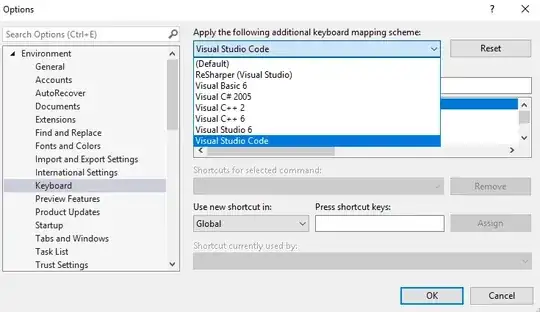

Apparently, VS2019 has finally introduced alternative keyboard mapping schemes. They're available at Options -> Environment -> Keyboard. I've been looking for a solution for toggle comment shortcut problem and I got a whole surprise package. This is more than I wanted.

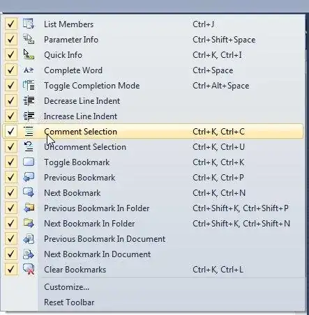

Ctrl-K and Ctrl-C will comment one or more selected lines.
Ctrl-K and Ctrl-U will uncomment one or more selected lines.
You can get toolbar icons that will do this by adding the "Text Editor" toolbar. In the toolbar area right-click and select "Text Editor" This will add a strip of icon buttons like this:
You can customize this strip by selecting the dropdown at the end of the ribbon:
To edit the keyboard combination go to Tools-Options and select Keyboard under the Environment tree. Here you can change the keys used to trigger the Comment and Uncomment actions:
