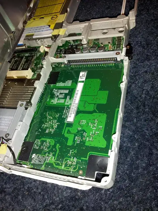

This ia a hard drive I pulled off my cousin's bricked iBook G4 (specs). The specs say the interface is Ultra ATA, which my research suggests is simply IDE, but it doesn't look like any IDE connector I've seen.
Here's the connector:
connector
Notice how there's only 1 row of pins, unlike 2 in IDE.
Here's the label:
label
Here's the spot in the mobo that it came from:
mobo
A link to the appropriate SATA/USB adapter (preferably under $5) would be greatly appreciated!
I think you ripped it out with some of the laptop parts. :) It looks like that connectors is supposed to be removable..
Mxx
  • 2,791
This looks a lot like the weird adaptors that Dell used to do - with a little bit of persuasion you should be able to pull the adaptor on the drive off of the drive to reveal the usual pin-outs.
You would probably notice a seam between the adaptor you're seeing and the 'usual' connector on the PCB.
This shouldn't need much force, and apparently you may need to rock a little to get it loose according to this youtube video. You can then attach this adaptor to a replacement drive or use a standard USB -> IDE adaptor to the drive itself.
