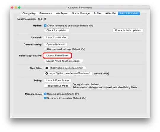

Use the Helper Application "EventViewer" to get keycodes

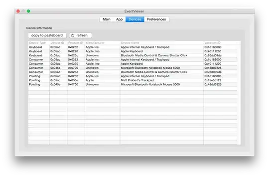

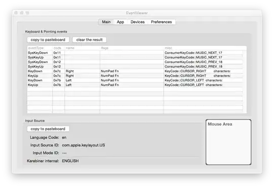

Open the EventViewer to get keycodes/application/device ids:
Go to the Main tab and then press the key(s) on your keyboard, bluetooth remote, etc you want to re-map. In this case you can see keycodes for Media-Forward and Media-Back on my Satechi bluetooth remote (which I want to re-map to arrow keys left/right).
Go ahead and "copy to pasteboard" and paste it in a text document for later. Now depending on your use case you may go to the App or the Devices tab.
If you want to limit your key remapping to specific applications, then you will want to create a mapping rule that is for a specific application ID (e.g. google chrome). So you would go to the app tab and get the application ID for your application of interest (to be used later when we create the rule).
In my case I ONLY want to remap these keys on my Satechi bluetooth remote and don't want to mess up how my existing keyboard keys work...so I want to make a device specific rule. So I go to the Devices tab.
Note!!! For apps and devices, you should also copy and paste into a text file so you have the complete device/app id strings for use in our rule.

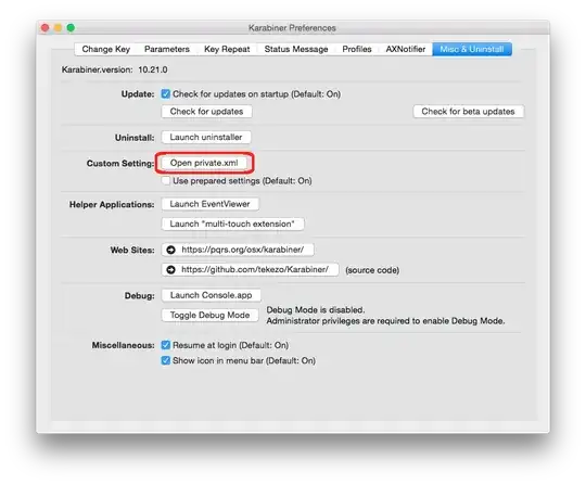

The default rules aren't very interesting to us, so we need to create a custom rule but editing private.xml
This will just launch a finder window showing private.xml. Go ahead and open private.xml in your favorite text editor.
