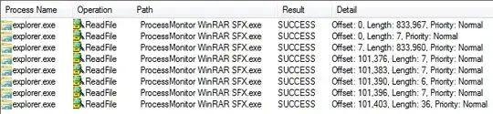

Finally, if you want proof that the file is actually being read by WinRAR's shell extension DLL (since you seem to doubt it), here are the various ReadFile calls registered by Process Monitor on simply right-clicking a WinRAR SFX:
(The process name is displayed as explorer.exe and not rarext.dll, because the context menu handler is an "in-process" COM object that the shell loads directly into explorer.exe's memory space for execution.)
As you can see, it reads the first 7 bytes to confirm that it's an EXE:
After reading more data (no doubt to obtain and parse the header), it then reads 7 bytes from offset 101,376 to confirm that it's a WinRAR SFX and not just any old EXE:
This prompts it to add various context menu entries such as Open with WinRAR, Extract with WinRAR and so on, which don't get added for "normal" EXEs.

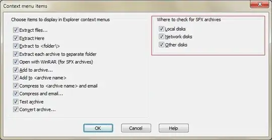

Furthermore, in WinRAR's Settings dialog there's an option titled Where to check for SFX archives:
Here's what the help file has to say about it:
"Where to check for SFX archives" options control processing of SFX archives in context menus. Checking contents of executable file and detecting if it is a self-extracting (SFX) archive introduces some delay when right clicking every ".exe" file, because WinRAR needs to read and analyze file data to find out if it is SFX. While such delay is negligible for fast local hard drives, it can be noticeable in case of slow network disks. This group of options allows to enable or disable SFX processing for local hard disks, network disks and other disks like CD-ROM and USB separately. If you turn these options off, you will not see all SFX related context menu items when right clicking SFX archive. So disable these options only if you really experience delays when right clicking ".exe" files.
