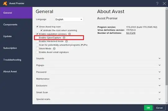

In Avast Premier 2017, disabling Hardened Mode does nothing! Instead you have to disable CyberCapture as shown below:
