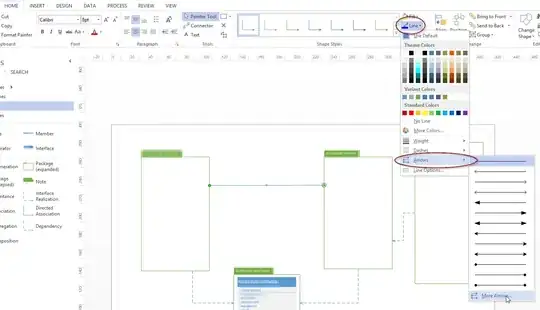

Insert your arrow as usual and then highlight it.
Once this is completed, navigate to the Home tab > Shape Styles, click the line dropdown and select the type of arrow you need.

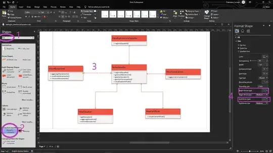

Visio 2019 update
The other answers didn't work for me, I found this way:
  1. On the left, search for line
  2. Under "Computers and Monitors" select Dynamic connector
  3. Select the connector
  4. Home -> Line -> Arrows -> More arrows
  5. On the right, under Format Shape, change Begin Arrow Type and End Arrow Type with the type of arrow you prefer.
