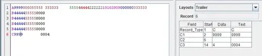

You could look at the RecordEditor RecordEditor it is not a Text editor (it displays the data in a table). It also has single record display + other views available.
The default is to select the record layout but the there is a "prefered layout" which will display each record using the correct layout for the record.
It does allow you to visually check the file
With the RecordEditor you can display the file in a table (following with prefered option
RecordEditor table display
you can also display in a highlighted text view (View >>>> Text View (Highlight Fields))
Text Editor View with highlighted fields
you can also mix-match, here the current record is also displayed in table format on the right hand side:
Text Editor View with highlighted fields and Single-Record View
