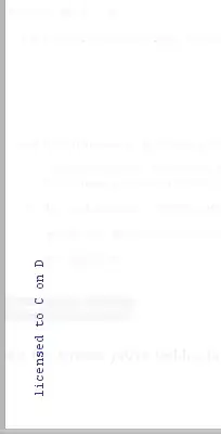

I liked that challenge. So here's a step-by-step howto:
  • Create PS template. That's a littly bit tricky, the text must be contained unaltered. (Export PS with Text as Text and do not include font -- phrasing as in CorelDRAW). Here is an example: stamp.eps

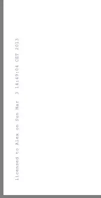

  • Use sed to insert customer's name and current date, export to PDF in one go. Of course, customer's name can come from DB-Query or what so ever...
    sed "s/to C/to Alex/;s/on D/on $(date)/" stamp.eps | ps2pdf -dAutoRotatePages=/None - stamp.pdf
  • Use pdftk to stamp this onto your original PDF file
    pdftk original.pdf stamp stamp.pdf output webversion.pdf
