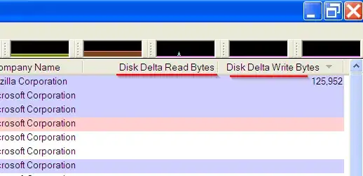

Process Explorer has a special column that tracks the change of the number of bytes read or written by a process:
You might be able to capture the name of the process that is reading or writing data to your secondary HDD this way.

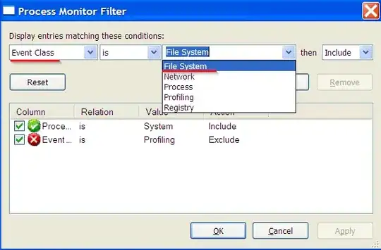

If you know that it is the System process that writes something to the external hard drive, you could trace what the process is doing in the Process Monitor:
Start/stop the capture with Ctrl+E.
Define some of those filters:
