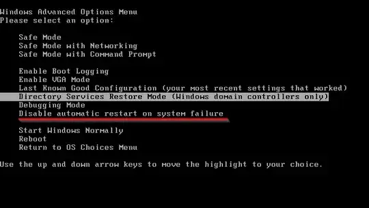

I don't know if this is what you're asking for. If you're experiencing a BSOD, then the BSOD should contain the information what driver module caused the BSOD. If you can't capture the BSOD message, press F8 at boot time and select:
