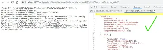

Here is a way with Chrome 97 and no plugins.
  1. Visit a API or JSON resource in the URL
  2. Open developer tools. (F12)
  3. Click the Source tab.
  4. Open a source or hit CTRL-P
  5. Select the JSON
  6. In the top, select Pretty Print
  7. You get nice JSON human-readable formatting!
Here is an example:
Jess
  • 885
    If you go to 'Network' instead you get an ever cleaner view in the 'Preview' tab – David Mulder Feb 23 '22 at 11:09
  • The pretty print option no longer seems to work? – Protector one Aug 31 '22 at 10:23
    @Protectorone when you open the file, click on `{}` at the bottom to pretty print the file. You can also preview the file from Network tab as @david-mulder mentioned but you will need to refresh the page if you went into developer tools after the page was loaded. – Praveen Lobo Jan 09 '23 at 15:46
