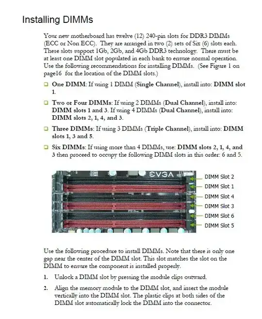

I'm planning to build a rig with EVGA SR-2 inside. It supports triple channel and has 12 memory slots.
The question is whether I will achieve triple channelness if i install 9x4GB identical DDR3 memory?
Well I assume I will, but nothing's wrong in making sure :)

    Read your motherboard's manual and find out. I'm voting to close this question as too localized, especially given the general narrative of the current answers. – Breakthrough Mar 06 '13 at 13:21
I downloaded the manual and this is what I discovered. I would say more but the manual answers your question.
EVGA Classified Super Record 2 (SR-2) Dual Xeon Motherboard
270-WS-W555-A2 - Manual

    I would like to point out its unlikely your motherboard supports a 6 + 3 configuration. I should also point out to use the other set of DDR3 DIMMs you will need two processors installed on the motherboard. I can say that it doesn't support a 6+ 3 configuration based on the fact it doesn't say it does support it and based on the 2/4 3/6 required configuration. – Ramhound Mar 06 '13 at 13:25
