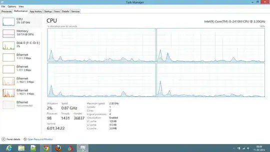

The up time shown in the picture is 6 Days, 1 hour, 34 Minutes, 22 seconds. I turned on this Laptop just about 7 min ago.
I actually think it like, Windows 8 reports the total up time while in Hybrid-Boot mode. How do I get the real up time?? Also, why does Windows reports it that way??
Is there any way to get the real up time in GUI way (for my n00b friend)??
UPDATE: I disabled Hybrid-Boot and rebooted. It now results the right uptime. Also, doing a full shutdown with shutdown /s /t 0 also works.
Little more explanation, My question is that How to get the actual up-time (time from when we powered the system on) even if the Hybrid-Boot is enabled? Possibly in stock Windows without any external program, though not necessary.
Any explanation to this?

    Can you clarify what you mean by "real up time"? What did you do 7 minutes ago exactly? – David Schwartz Mar 11 '13 at 13:07
  • Real up time means the actual time from when I turned on the system. (That's what I did 7 min ago, turn on the Laptop!) – Akshat Mittal Mar 11 '13 at 13:32
    The legacy definition for uptime is the time that the computer has been running since the kernel initialized itself. Since hybrid boot is just a special type of suspend (there was previously suspend to RAM and Hibernate), it doesn't count as "shutting down", because the same instance of the Windows kernel is used. – allquixotic Mar 11 '13 at 13:56
  • @allquixotic True, That's why I thought it would be Hybrid-Boot up time. – Akshat Mittal Mar 11 '13 at 14:15
  • I guess you din't actually got the Question. I want to ask that how to get the actual up-time even when Hybrid-Boot in enabled. I am updating the question. – Akshat Mittal Mar 12 '13 at 14:25
