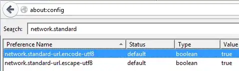

In about:config set
network.standard-url.escape-utf8: false
After this path copied as not encoded. But ancor keep encoded. :(
UPD:
Found updated config Value
The setting was replaced with browser.urlbar.decodeURLsOnCopy in Firefox 53+.
https://superuser.com/a/1255451/17118

Edit
It appears as of Firefox 60 it is no longer possible via the methods in this post, but I'll leave the post for historical reasons...
Open the config page in Firefox by typing in about:config, then promise to be careful and enter.
Type network.standard-url into the search box.
Ensure both values are set to true.
Source
Edit
As per mmv-ru comments, setting escape-utf-8 to false helped. So I assume keeping encode set to true!
