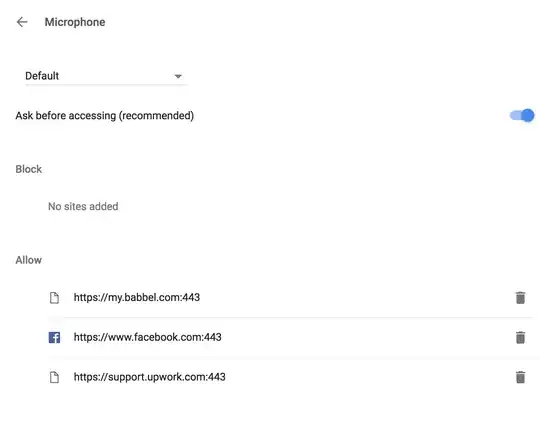

Just to add my two cents, this may be a Chome issue as well. My microphone was blocked for the Google Hangouts in the Chrome settings and needed to delete from the list.
Arefe
  • 495
For me, I clicked the lock to the left of the link when you're on google meet. Go to site settings. Then under microphone, switch ask to allow. Then restart chrome and it should work. Hope this helps. It worked for me.

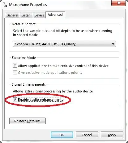

To resolve this, all that needs to be done is to disable mic enhancements, assuming that you have configured your Hangouts to use correct input and output audio devices. So lets get on with it.
On Windows system go to Control Panel, Sound. Then click on Recording tab, highlight your microphone and click Properties. You should see something like this:
mic no sound in google hangouts
Uncheck the ‘Enable audio enhancements’ hit Apply or just OK and you should be good to go.
I've published this solution on my blog: http://www.dolejarz.com/no-sound-in-google-hangouts/
