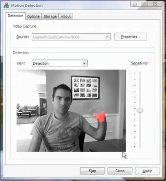

There is "Motion Detector" (at the bottom of this page), reviewed on LifeHacker.
alt text

  • Had a go at this one. Turns out it has a limit of 60 minutes as well! Moreover, it has absolutely no indication of when it has triggered, so I ended up recording a whole lot of noise. Unimpressed. YawCam next... – RomanSt Oct 18 '09 at 09:51
