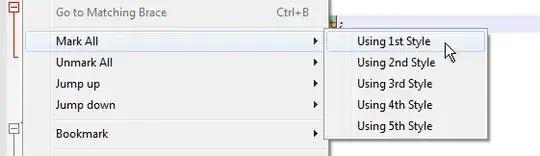

Alternatively, while you have the word selected, you can use the Mark functionality in the Search menu:
This also allows you to mark all occurrences of a given string in the document (and you can even have multiple markers going on simultaneously).

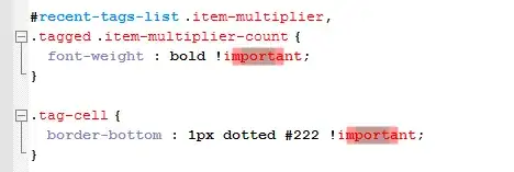

Please note that both approaches work perfectly fine with partial words. In fact, multiple markers can apply to the same partial string. Here I've used a marker for port and one for mporta:
Using multiple markers simultaneously
