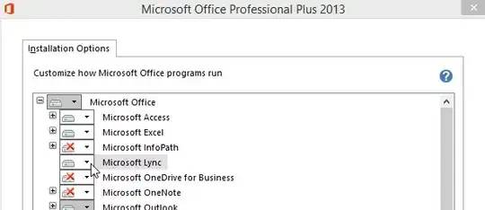

You can also uninstall Lync if you don't need it (part of the Microsoft Office).
Go to the Control Panel - Programs and Features and right click on Microsoft Office 2013 and choose Change.
Now you can continue to Add or Remove Featues and uncheck the Lync feature:
