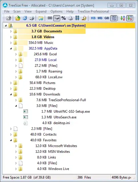

Use TreeSizeFree and run it as admin (this is very important to see hidden/system files and folders).
Now you see a nice overview of what is using the HDD space:

  • Thank you for the idea - TreeSize is a nice little program. Unfortunately it only told me what windows explorer and a spreadsheet told me - I have a 714Gig Partition that windows shows only has 62.Gigs free (deleted stuff since first post). According to Windows Explorer, Treesize (run as administrator) and JDisk Report there is only 285.5Gigs of data on the disk. So... What is using up the other 366Gigs? Not in any hidden file, folder, or partition. – Chris Kelly Apr 01 '13 at 21:03
    @Chris Kelly run **chkdsk /R /F**, maybe the NTFS metadata are damaged and show you wrong data. – magicandre1981 Apr 02 '13 at 04:19
  • this, and most other tools, won't show the actual disk consumption because of "Windows Side By Side" or `winsxs`, see http://superuser.com/questions/1/why-does-the-winsxs-folder-grow-so-large-and-can-it-be-made-smaller – matt wilkie Apr 30 '13 at 16:44
  • Thanks! TreeSize was the only solution that showed me that "C:\System Volume Information" consumed too much space. Otherwise, this directory wasn't shown for me even when I enable showing of hidden files. – AbstractVoid Dec 03 '20 at 00:01
