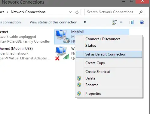

There is another way of doing this. Follow these steps:
  1. Open Hyper-V manager
  2. Click on the Virtual Network Manager and create an Internal Virtual Network by selecting Internal and clicking Add.
  3. Give a meaningful Name
  4. Apply and OK
Now go to your host machine and in the Network and Sharing Center click on Change Adapter Settings.
  • Select your dongle adapter and click Set as default connection.
  • Click properties and click on sharing tab.
  • Check Allow networks to share internet and select the internal connection just created.
  • Click Apply and click OK.
  • Finally go to your Virtual machine settings and select the internal switch we created and click Apply and OK.
