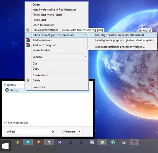

My laptop has an RMB option on applications which allows you to specify with which GPU to run an application with: enter image description here
But after launchin DXdiag with this option, or the second, I always get this screen: enter image description here

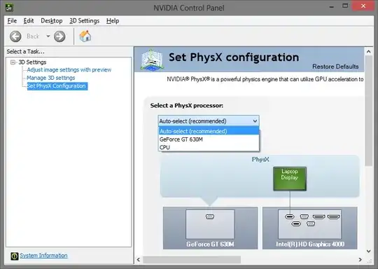

I tried looking into the NVidia CPL but it doesn't have as much options.. as it should?:

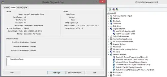

So I looked it up in DXDiag:
And what suprises me here is that there is absolutely no GPU/manufaturer name and the default windows drivers are used..

    One more thought occurs: Your screenshot of the nvidia control panel shows one hardware output connected directly to the nvidia frambuffer (it appears to be a d-sub). You might try connecting a display to that output (verify in the nv. control panel that it shows up connected to the nvidia card and not the Intel one), then run the game on that display. Doing this will remove the IGP framebuffer from the equation completely, and may give you a hint as to the source of the trouble. – Fopedush Apr 22 '13 at 21:05

A final workaround for optimus-related issues exists in the hardware outputs of the video card. The Nvidia control panel, as in your screenshot, can display which physical outputs are connected to which monitors. From your screenshot, it appears that the Nvidia GPU has one physical output - You can try plugging an external monitor into this output and confirming that it appears connected correctly in the Nvidia control panel. If so, your montior is now hooked directly to the framebuffer of the DGPU, meaning that optimus is not in use, and all rendering on that monitor will take place on the DGPU.
