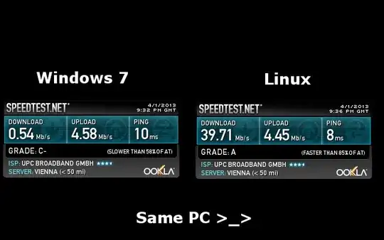

I have recently had a hard drive failure so I was forced to reinstall my OS (Windows 7). After a fresh install, I noticed the internet speed became extremely slow (~15 minutes for downloading a 20MB file). I have installed all available windows updates and drivers.
I have a cable connection that is supposed to be 40Mbit, and this was the performance I was getting before the reinstall, as well. Between the modem and PC there is a SMC SMCWBR14S-N2 router.
I have other machines on the network, a PC with Windows 8 PRO which is connected by a lan cable and another Win7 machine that is using wireless lan. Both of these other machines show full performance (40Mbit) when downloading and also on speed tests.

I also have Ubuntu installed as a second boot option, and experience full speed with it, with both NICs. If I go back to Windows, it becomes slow again. Here is a comparison from speedtest.net: enter image description here

    what's interesting is that your upload speed remains constant in both cases. something is interfering with downloads only... try disabling anti-virus and firewall and run the test again maybe? – roryok Apr 08 '13 at 09:01
